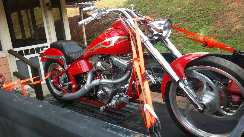

    I Love This Bike as did my Dad. But it has been a nightmare to keep running from day one. It is on the truck more than the road.[​IMG]

  2. pknowles
    Supporting Member Full Member
    Jul 10, 2010
    8,144
    7,317
    virginia
    paul
    Looks good even in the truck.
