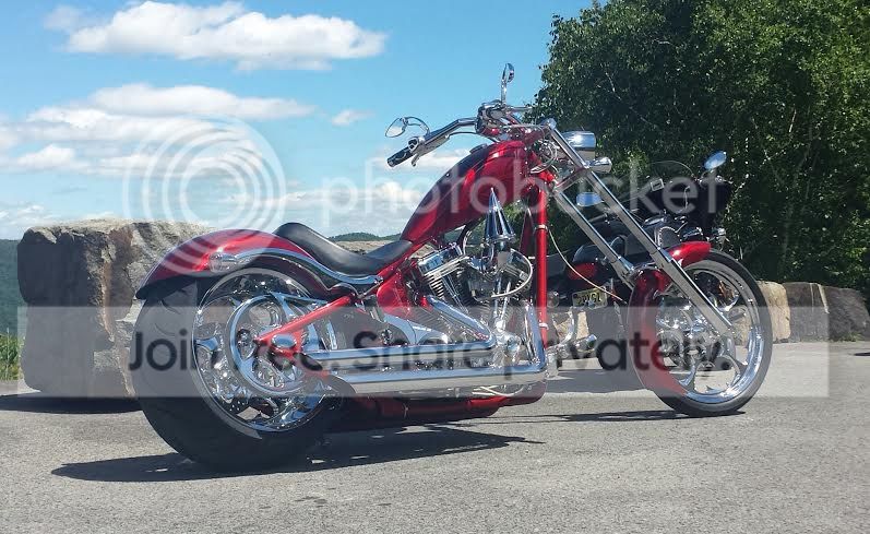

I have these Hooker exhaust pipes and I am just about convinced that they might be an issue, meaning not even remotely matched to the engine design of the S&S 117. I just feel that they might be too large. Besides that, the back pipe has an issue for certain, and that is the band spot weld broke off leaving the chrome casing to vibrate/rattle near the cylinder head. The primary pipes seem very short and then it dumps into a very large area (2.5 inches) for a great length. They didn't have baffles when I bought the bike. The other issue I am having is a very annoying popping when the carbs throttle blade is closed during de-accel. Like gun fire. To me that back firing is not acceptable. The motor seems like it has ok power, but nothing special by any means.
I can use all the input as possible with your own experience on exhaust pipes, really thinking about getting rid of these.
Does anyone else have an issue of back firing during de-accel, throttle blade closed?
P.S. not going to accept from anyone, that this back firing is normal.

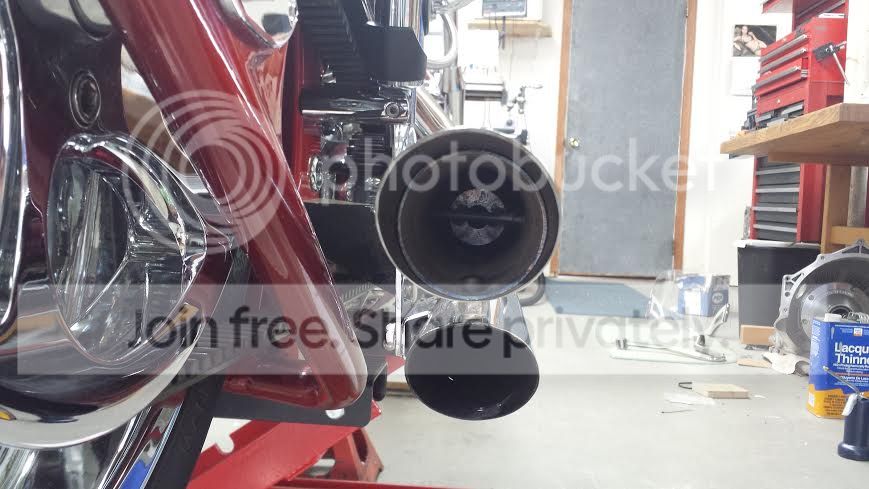

Thanks for the link. I measured my i.d. and o.d. on my current Hooker pipes seen in the pic. The o.d. is 2.500 and the i.d. is 2.400. If I was to cross this mathematically to what we build for the race engines in the shop, a 2.5 pipe typically would require an engine, per cylinder, that would make 160HP on the average, and our typical run rpm is from 7500 to 8800. That's 320HP if you add 2 cylinders up. I highly doubt my S&S 117 makes even remotely anything near these figures. Effectively my Hookers are really a 1 3/4 pipe for about 11 inches. I bet it wouldn't make a darn difference if the remaining 3 feet of 2.5 inches where not even there. Seems that they are just absurdly too large.
Now to find baffles that will fit that i.d. I guess i'll try baffles before I bail on them.

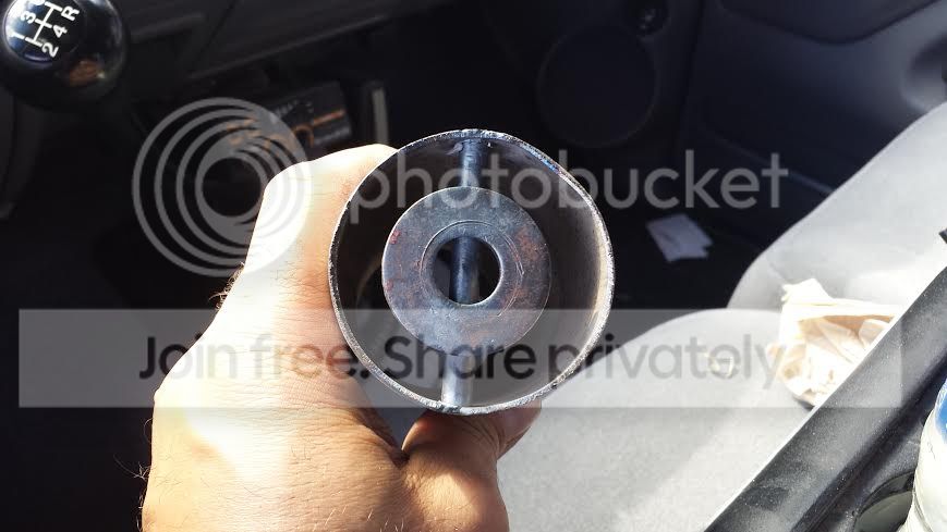

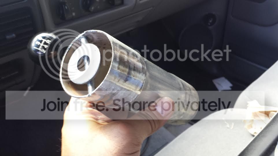

I figured it couldn't hurt to make something in the shop and give it a try. Made two insert baffles. This should give it some back pressure.
Looks like what you would pay $80 for from Thunder City

Just an update.
I installed the baffles and there was a noticeable difference. The engine no doubt needed some sort of back pressure. It runs smoother, seemed to have picked up the throttle response a little bit as well, at all areas. It got quieter, not a lot, but noticeable. The back firing is still present, although not as much and not as loud either. I'd say I knocked 30 percent of the back firing away. A little disappointed because I really thought this would cure it, but definitely glad I did it.
Here is the craziest thing about it. I've been kinda fighting this slight tick in the front rocker box, and I have done quite a few things to quiet that front box down, but no luck. Apparently that tick which sounded exactly like rockers or maybe even a guide going bad, was actually combustion in the first few inches of the primary pipe, and close enough to the head that it would give the impression that it was up in the rocker box. The baffles must have put the back pressure into it whereas now all the combustion is occurring in the chamber. WTF? The rocker box is quite now, just like the back one, not a sound out of it. Who would have thought. I'm still shaking my head, but very happy because I couldn't find anything in that top box that would amount to that rocker tic sound.
